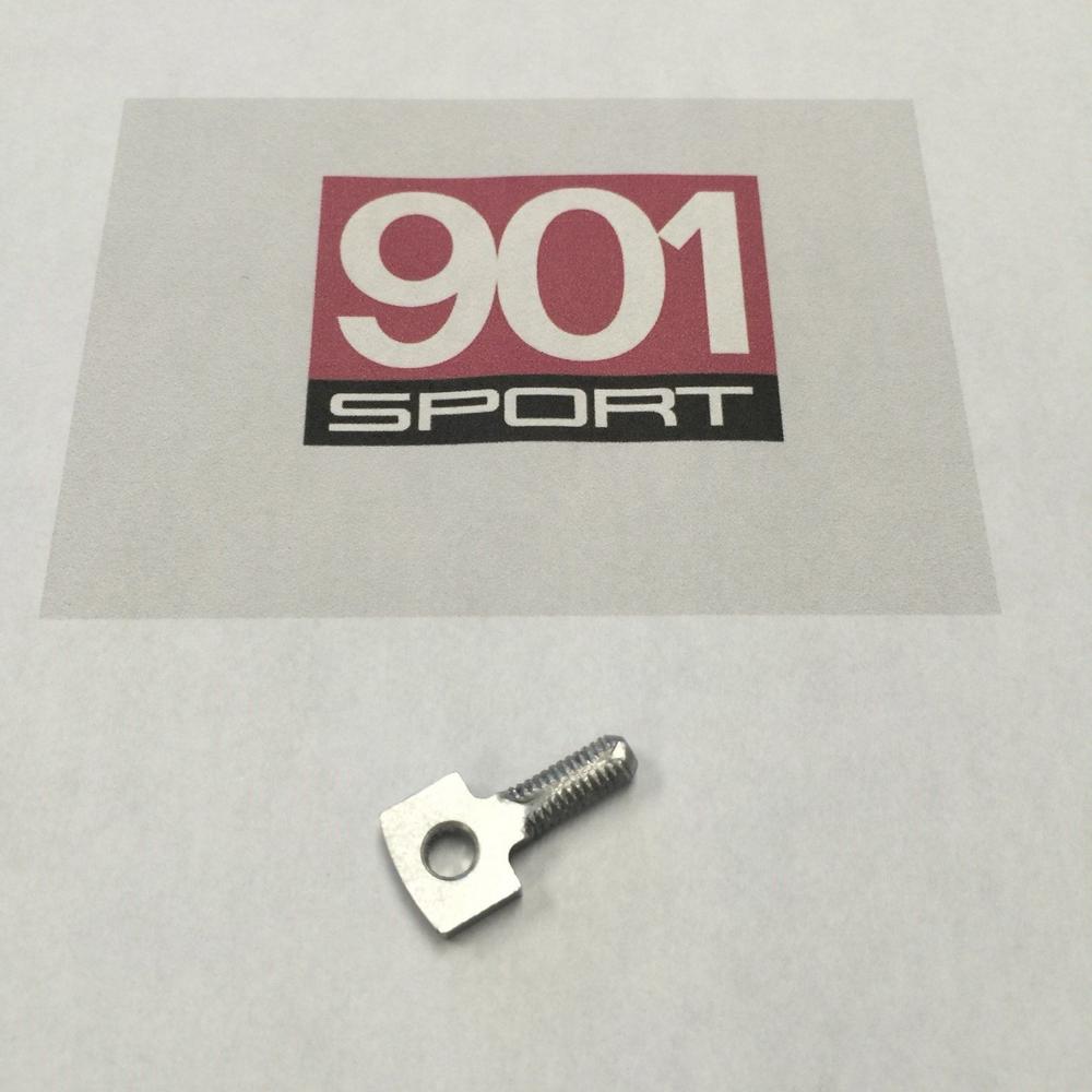

    Hi Guys, I have an aluminum deck lid grill. The studs that hold it on, and extend into the hex spacers for plastic rain tray, are broken off. Does anybody know if these are available? Thanks, Tom
    Sierra Madre has them......the weird square head, aluminum ones.

    A forum member, Erich Wilms has been making these for many years.
    His store is 901sport on ebay, $76.00 for a set of 8.
    Since you mentioned 'rain tray" these may also be of interest:
    PET '65-69 911 Fig. 8-03-05 #25 N 010 207 6 Hexagon-head bolt, M5x12, '69-, 912 Qty: 6
    PET '65-69 911 Fig. 8-03-05 #26 N 012 005 3 Lock ring, B5, '69-, 912 Qty: 6
    PET '65-69 911 Fig. 8-03-05 #27 900.025.003.02 Washer, 5,3 '69-, 912 Qty: 6
    PET '65-69 911 Fig. 8-03-05 #28 902.512.125.20 Spacer, '69-, 912 Qty: 6

    Thank you JimmyT
    I also sell them individually.
    Free shipping...
    Erich

    Porsche sells them new . Sunset Porsche

    Quote Originally Posted by CDOUGLEHMAN View Post
    Have you purchased them Doug? I know way back I used the original part number and received the new style, that's why I ended up making them. Maybe they have redone them properly now.
    Erich
    Early 911S Registry #263
    Aug 2011
    Virginia Beach Va
    426
    I have and they look just like the ones pictured on the 901 picture.
