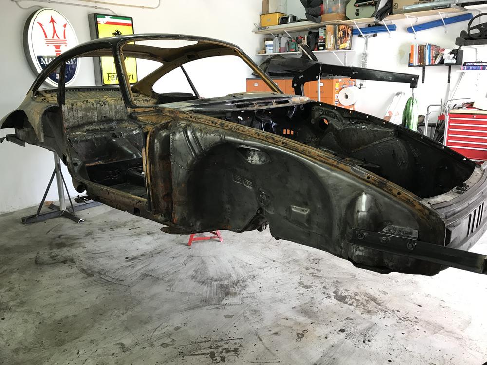

    Another update from the 911 T/R Project. As of this last weekend, I have finished cutting all the metal that was not from the car or was too rusty to keep. As you can see from the photos I have removed a lot of metal!
    Next step is blasting and them metallising the body.
    Some of you are probably thinking that I am crazy cutting the car like this without having it on a jig. Rest assured it will be, eventually going to one but only after this process...

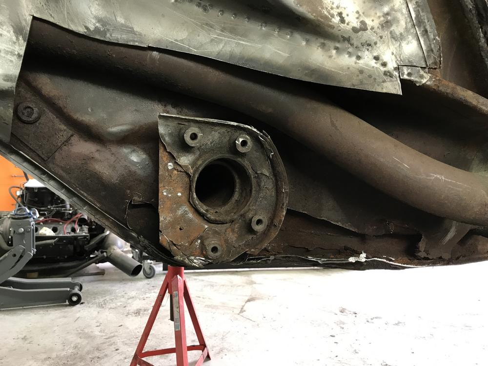

    One more photo, so you guys can explain to me what is this for!
    Sep 2009
    UK
    2,701
    Those are mounting points for 3 point race harnesses. Interesting project. Good luck with the build.
    Hi Stretch,
    Thank you! I did a google search and couldn't find any photos of such harness. Do you have one? this could be interesting to use on a period looking car.
    Btw, had a look at your build thread. wow! it took you some time but that is exactly what I am going for! you got one more follower!
