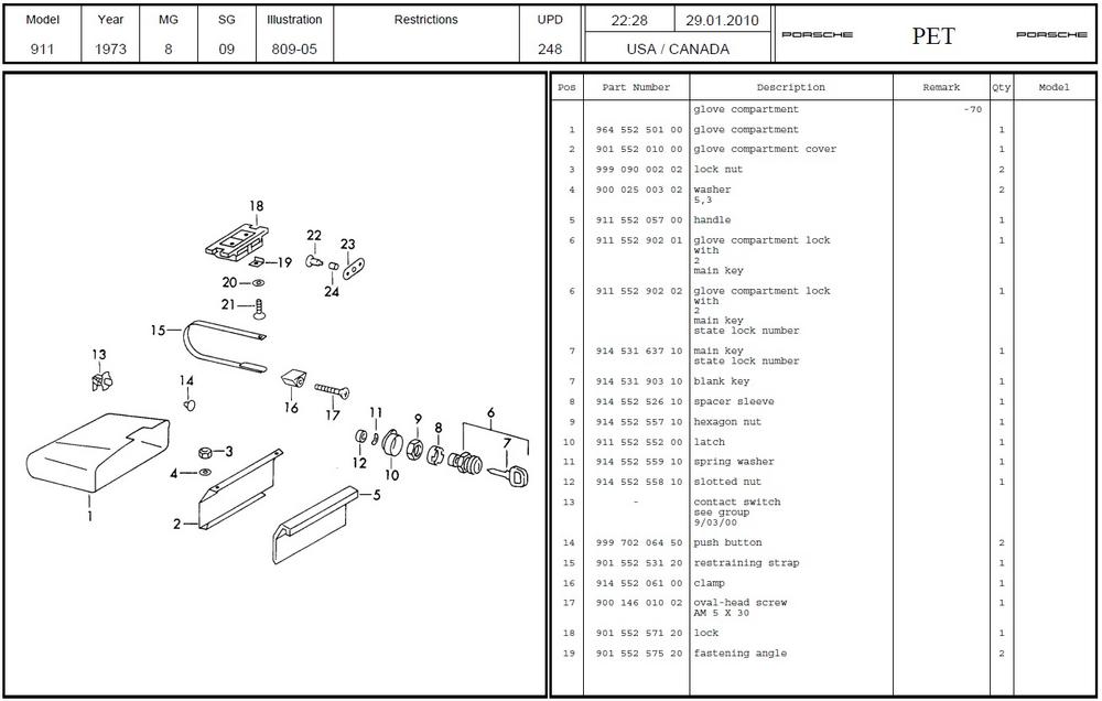

    [18] of the drawing appears to have two secured spots left and right of the box, that may allow removal of 9 -10mm nuts with 1/4" drive socket if they are present..and then a few bits of mask tape to assist the reassembly.
    If you remove the knee pad you can access the screws that secure the lid hinge to the dash frame. The latch is just a rotating tab, and even if locked when you loosen the hinge the lid should drop away. You shouldn't have to loosen the strap holding box itself.

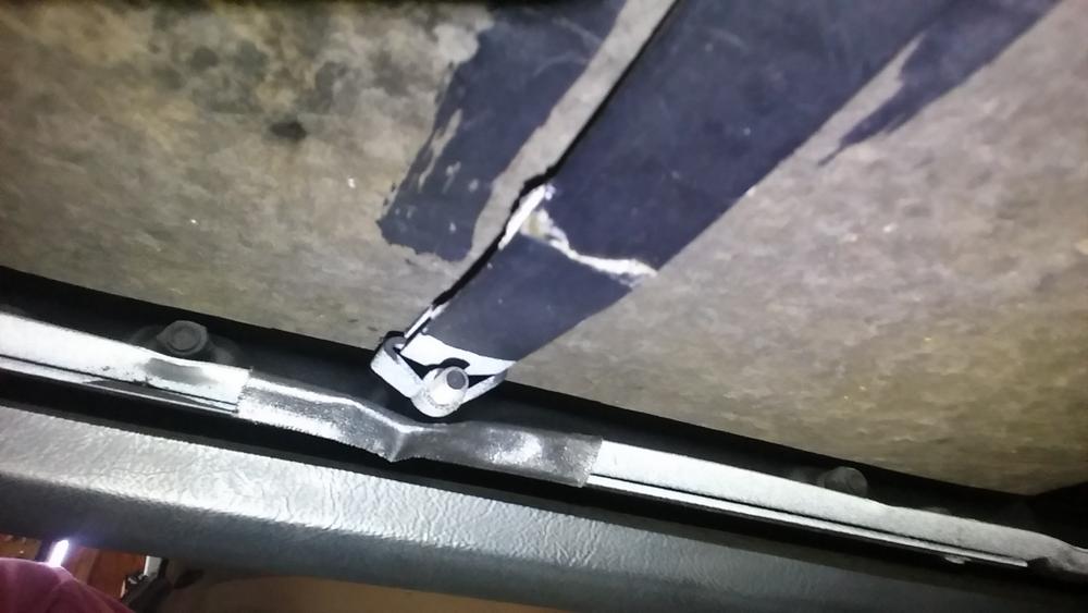

    With the knee pad removed, I need to figure out how to detach the glove box door. There appears to be 4 - 8mm nuts that attach to the base of the door from the frame. One pair of nuts from the bottom and one pair from the front.

    if the glove box door is closed, screw 11 should be hidden by door 3.
    it is possible to bend the end of strap little by litlle straight and pull it out of 10.
    use a plier and turn screw 3 to loosen as far as possible. there are some mm space to the door 3. pull the screw and clamp 10 away from the dash in direction to the trunk and turn the clamp loose.

    Besides screw 11, there are 4 bolts holding door 3 in place. I was hoping by removing the knee pad, I would gain access to screw 11. But the door base below the hinge covers screw 11. In my attempt to remove door, two of the bolts with 8mm nuts will not unscrew because the bolt moves with the nut. The head of those two bolts are covered by the closed door base as well. And then there are the other two 8mm nuts attaching the door base to the bottom the dashboard frame. Removing those two 8mm nuts apparently doesn't loosen anything up either. NOTE: other parts illustration below with more detailed break down of lock. I'm not sure which diagram is specific to my 1973 model year. But neither depict the 4 - 8mm nuts and bolts that anchor the base of the door to the dashboard frame.
