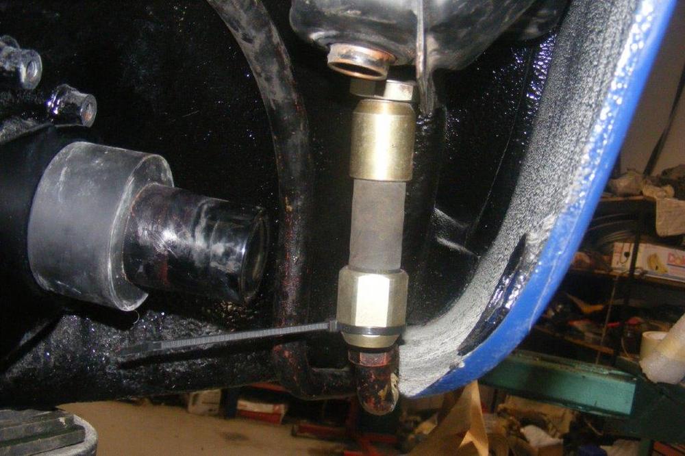

    This one?
    (just sitting as we mock up)

    Senior Member dirk07's Avatar
    Apr 2016
    Stuttgart, Germany
    3,352
    Thanks Ivan,
    yours look like the correct one, that I had in mind, when I ordered mine.Name:  oil connect.jpg

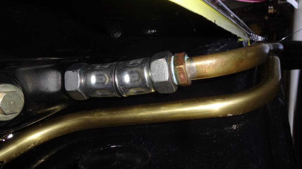

    The one, that was sold me, is way to short.Name:  IMG_2522.jpg
    The seller says, that it fits, but in his picture the used oil tank looks different, or?
