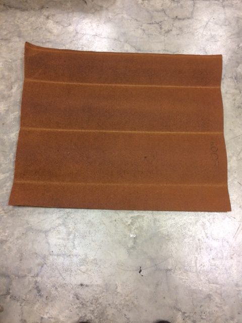

    Here's what came out of my 65 911, 1744. It's 28.75" x 33.5" (w); 0.25" thick. It can't weight more than a pound. You can clearly see where the bows press into the surface for support. It was lightly glued in place.

    It is amazing that you got that out in one piece mine was a broken up into very small pieces .
    Thank you for the measurement!

    When cornering fairly hard I hear what I've suspected is a piece of this pad sliding across the headliner. Everything looks fine though and I'm really hesitant to do anything about it.
