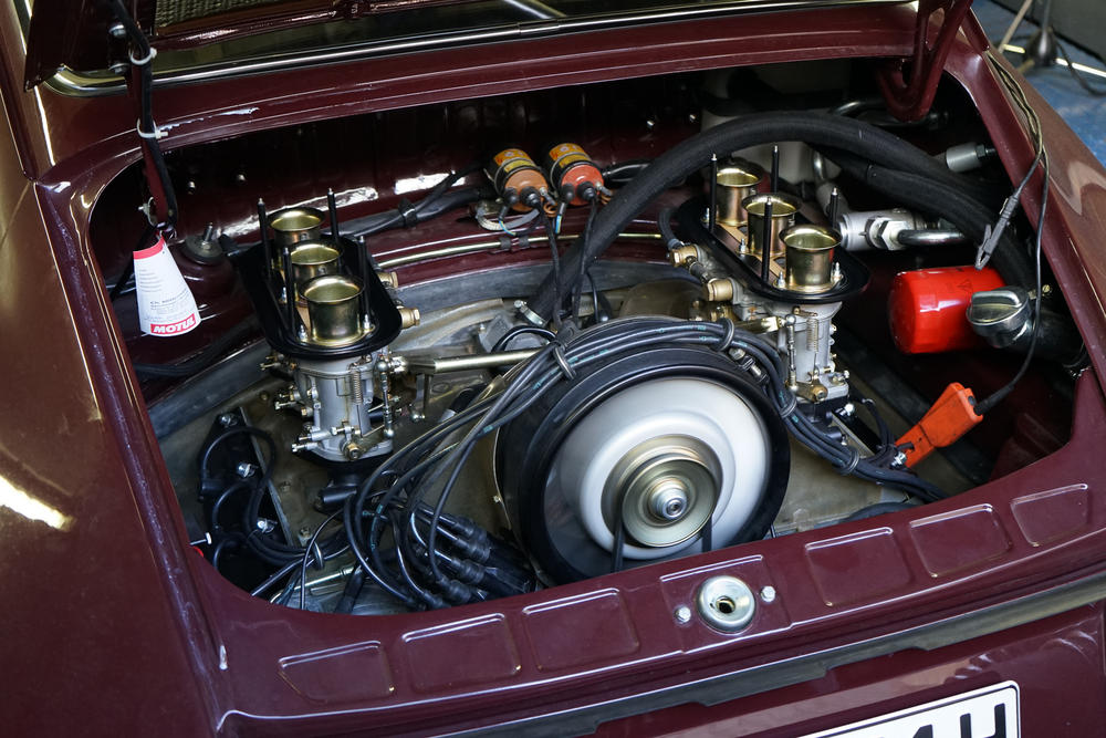

    Hi,
    I just finished restoration of a 2.2S which comes with a 2.2S engine modified regarding displacement (89mm Mahle racing P&C's, 1:10.3 c/r), Weber IDA40 instead of MFI and twin spark distributor.
    I'm quite happy with the engine, delivering almost 220 HP and running very nicely above 3,500 rpm, ok between 2,200 and 3,500, but bucking between 1,800 and 2,200 when putting the pedal to the floor (e. g. when accelerating in second gear at about 20 mph out of a steep turn uphill).
    Measuring lambda values show the problem very well, see dyno diagram attached as pdf.
    However, as everthing is new, and as the car has been on the dyno 3 times for carb and ignition tuning, the problem still remains.
    What has not been done in detail so far is playing with the acceleration pumps at both carbs, so that could be a reason.
    But in case this is not the problem, any experience here what to try?
    For example, which effect would high manifolds or smaller/bigger venturis have?
    Thanks so much!
    Siegfried

    Hi guys,
    thanks for your thoughts so far.
    - Port sizes are stock 911S 2.2, intake manifolds and carbs are from an earlier 2 liter 911.
    - Distributor is electronic, timing advance curve is programmable and was adjusted on the dyno, 500: 20, 1000: 4, 1500: 16, 2000: 25, 3000: 28, 7500:28, limit at 7500
    - air/fuel ratio: see lambda value in pdf (rich mixtures λ < 1.0, and lean mixtures λ > 1.0.)
    - jets and settings should be thoroughly adjusted, synchronization should also be ok. Don't know the jet sizes right away, but will check
    I agree that further carb tuning could be an option.
    What about higher intake manifolds or manifolds with bigger diameter? Weber IDA46?
    Thanks,
    Siegfried

    No, not a misprint. The guy who programmed the distributor with the car on the dyno explained to me that this was his method to stabilize idle behavior. Especially when headlights/high beam are being switched on, the engine continues to turn at around 800 /min. So that works well.
    But the problem is above 1,500 and it's good to hear that you think it can be done
    Besides jetting and setting the carbs (I need to find out the current settings including venturi sizes first), what would be the impact of higher intake manifolds or bigger carbs? Could the acceleration pump setting be an issue? I tried to set them according to Porsche workshop manual spec, injecting about 0,5 cubic centimeters into cylinders #3 and #4, assuming that the others in the row would work in the same way. Might have to spend more time here...
