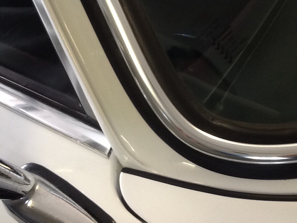

    Photos of troublesome areas. Name:  image.jpg
Size:  138.9 KBName:  image.jpg
Size:  164.2 KBName:  image.jpg
    In second photos the angle makes the seal appear narrow on the corner, it is uniform all around like the last photo.
