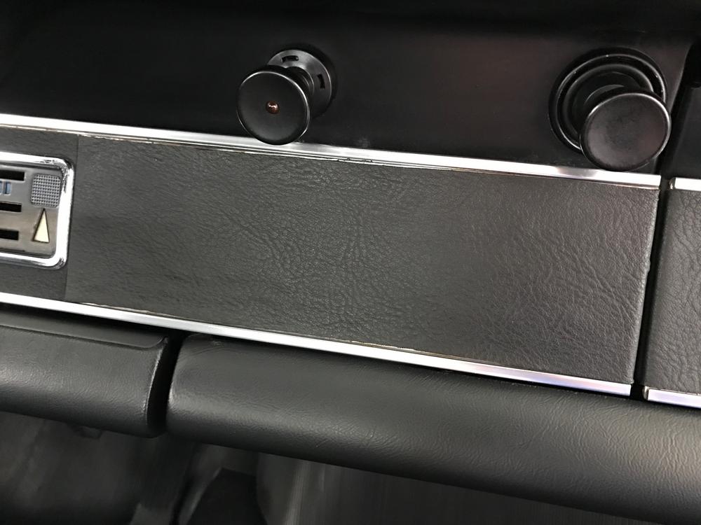

    I want to go from this:
    to this. Is the pic below done properly? Who has vinyl that will best match the original pieces in the car?
Size:  92.7 KBName:  19AC4D75-1461-4137-BF2C-D0DAC40DC18C.jpg
    I did not wrap over any edge. I cut it very close to fit the plate minus a bit on top and bottom to allow for the recess. and used contact cement to glue it down. Once I had the fabric on I had to bend the plate to get it to go behind the recess. Maybe you can slide it with glovebox open? It came out really well. When you take your current radio and plate out I think it will also show that fabric is not wrapped.
    Your radio looks like correct timeframe for a 73....curious about your radio delete....does your COA specifically say radio delete on it? Because I could be wrong but I thought in US a lot of radios were installed at the dealer.
    Not sure who has the best black material like yours....i had the basketweave....maybe stoddard.com? Others should know.
