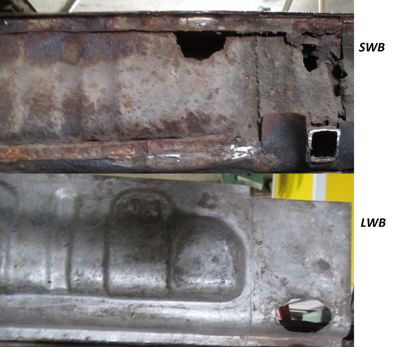

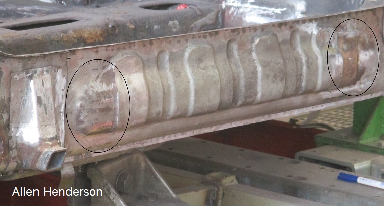

    Does anyone have some good fotos of the inner rocker(s) on early 901/911 up to say 300100? The aftermarket parts while very good are not totally correct. Here are two photos from early cars but we are looking for earlier and better fotos. This is needed for 901 300061. Thanks.

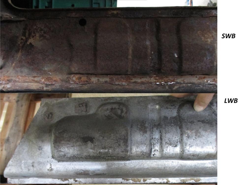

    hi Allen
    those inner rocker panels available are all LWB type for paper type silencer tube.
    i will get you pics of #57 ...panel on the right was missing but maybe the driver side was still present.
    f.
    2nd of "your" pic looks very familiar to me
    Thanks Franz !
