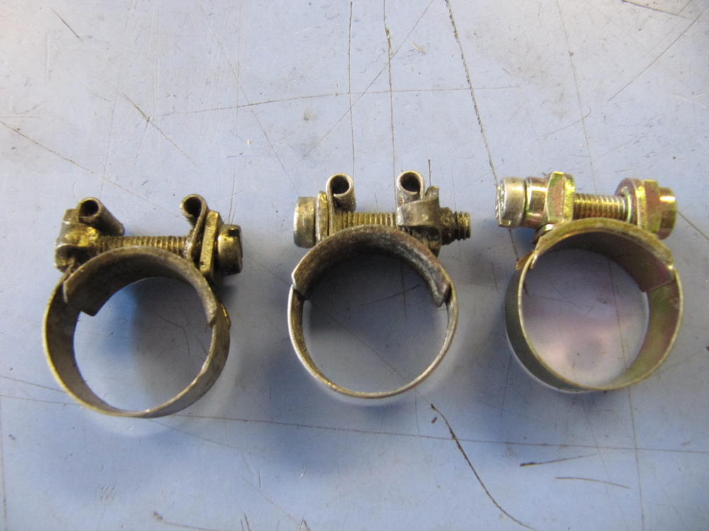

    Hi Richy, thank you for your reply but those clamps are covering a range of hose sizes but the clamps I am talking about are for one size only.
    These pics are showing the correct type clamps with at the right side the Norma S-type clamp for 18mm hose. (Thanks Jim Breazeale)

    I have moito already sent a pm but I would also like to know the sizes of at least the top two. Then I know what I am looking for and I can also search elsewhere with an indication of the desired size.
    Will there be enough members here who know these sizes?
