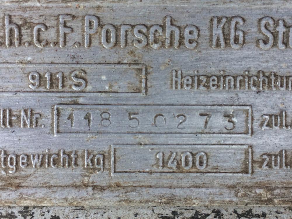

    We need to know the production number from the dash frame.
    VIN Reference = 11850273
    Peter Kane
    '72 911S Targa

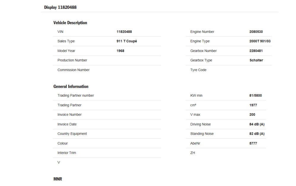

    Davep, I didn’t manage to send you the attachment about the other car we were talking about through PM.
    Here it is:
