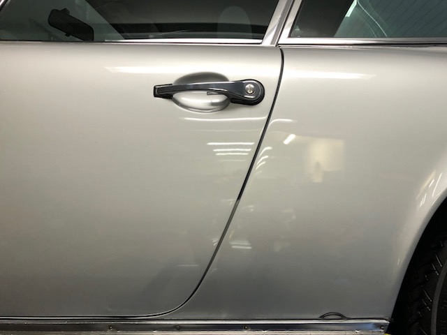

    My car was repainted prior to my purchase in San Francisco. The one issue the car has is that the drivers door doesn't close with the normal amount of force that the passenger door and my other porsches do. Basically have to push it twice or once very hard. The best that I can tell is that the door slightly moves up on the final close. But not by very much. I can't see any special binding or indentation on the door seal that would indicate something (all new seals after the paint). The door gaps themselves seem normal, at least to me. See pictures. So I am looking for any common fix suggestions or other way to figure out whats causing this. Thanks in advance...

    Did the body shop remove the hinge pins, or unbolt the hinges to remove the door? If like most they unbolted the hinges you've now lost all the factory fit. Having dealt with this more than I care to from body shops too cheap to buy the hinge pin slide hammer, then I have to refit doors on a freshly painted car. Look at the hinge pin bolts, if they have wrench marks then that's what was done. There is a certain procedure to get the door back lined up, you MAY end up chipping paint if not careful. I can go thru the whole story if you feel capable, best to take it back to shop and make them do it correctly.

    From those pictures, it looks as if the whole door is low in the opening. Yes, take to a competent shop and get that adjusted correctly. Lowering the catch might make it close a little better, but if the whole door is off a tick, that is just a band aid solution.
