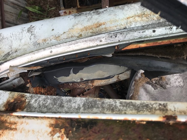

    I am looking for a drivers side rear window trim molding for a 1966.
    From what i can tell, they did not have screw holes in 1966.
    I have found some from 1967-1968 that have the screw holes in them as pictured.
    Would 1965-1966 be screwless?

    The one that you have pictured is a 68 or later aluminum piece. 65/66 are made of brass and are "screwless".

    My '67S, Oct '66 production, and my old maroon binder '67 parts book show brazed pins with speed nuts below...no screws top, as '68 on.

    I've got this:
    It's re chromed, but does need a mounting peg

    nice. so 1965-1967. no screws.
