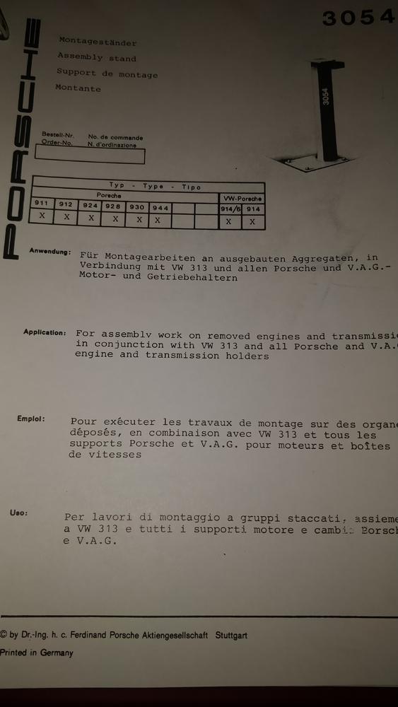

    Matra I've shown in post #4 is special tool 3054. Close up of its labels tale earlier today:
    Matra is a well known German tool maker used by various OEMs. According to my copy of the later Porsche special tool catalogue VW3054 is their Porsche (and others?) stand suitable for air-cooled 911 motor and heavier 930 as well as engines front engined water cooled cars . Page dated 82 from the book pictured here for information

    Porsche has utilized many factory Volkswagen tools since the 1950s.
    The 3000 series were factory Volkswagen Audi tools, all with specific or general applications to their vehicles. The majority do not have any Porsche application, and none have a Porsche-only application.
    For example, tools 3051, 3052 and 3053 were for Volkswagen Vanagon vehicles.
    The image presented as a Porsche site is actually a Snap-On site.
    Snap-On is an authorized distributor of factory Volkswagen tools, including those with Porsche applications. They do not sell or distribute factory Porsche tools.
    The Snap-On Porsche page for 3054... https://porsche.snapon.com/special-t...itemId=2410133
    The Snap-On VW page for 3054... https://vw.snapon.com/SpecialToolsDe...itemId=2410133
    The Snap-On Audi page for 3054... https://audi.snapon.com/SpecialTools...itemid=2410133
    The Porsche Special Tools catalogs list many Volkswagen tools with Porsche applications, but as the catalog indexes state, an "X" in the order number column indicates that tool is not available through Porsche.
