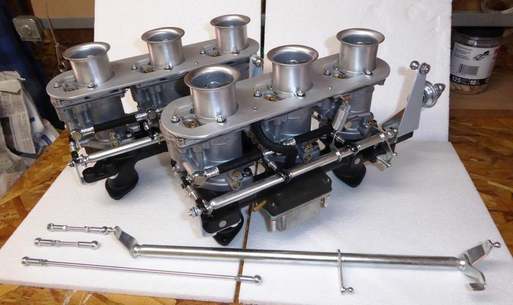

    I like the look of Solex carbs when they are finished so I share a photo of my last Solex project along with some thoughts on why they were such a problem for Porsche.
    Solexes were the factory's choice for production engines but Webers were used on race engines. When Solexes became a re-occurring problem for maintaining tune Porsche had Webers already developed so Solexes were replaced with them beginning in February, 1966.
    Issues the Solexes suffered:
    • erratic throttle valve closure rendering poor idle performance (they would have benefited with positive, screw adjustable throttle stop screws and concentric throttle return springs)
    • fuel floats that absorb fuel and sink which caused flooding issues (brass fuel floats would have solved this issue)
    • throttle actuation lay-shaft was mounted in simple bearings which caused it to further hinder accurate throttle valve closing
    • complicated fuel delivery system involving mechanical and electric fuel pumps (a simple flow control metering system to supply fuel to the carbs and a scavenge pump with a return to fuel tank system would make the spill tube design work well.)
    • throttle shafts were supported by mostly Teflon bushings (only a portion of the shaft was actually supported by metallic bearings which lead to wear induced throttle shaft movement which degraded low speed idling performance.)
    • In addition to the above, these were six individual carburetors with a confounding level of redundancy and complication.
    This set has new floats of brass construction, a real PITA to make:

    Gorgeous PA,
    In my opinion anything that looks as good as those, is / are allowed to have a few personality idiosyncrasies.
    Mark

    Paul, that looks like quite a bit of work to do the floats! I did a small batch of 3D printed nylon floats which seem to be performing well(none for sale). Enjoy your retirement!

    I am proud to own some of Paul’s Solex work.
    It’s exquisite.
    Who said retirement????? Just no more Solex projects.
    Thank you Frank for your "over-the-top" compliment.
