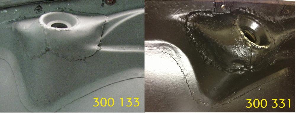

    The shimmy in the steering on the very early cars caused the steering wheel to move to a heavier - steel frame - (compare also to the really heavy 1967-68 steel steering wheels with the weighted hubs).
    Factory review looks to center on the stability of the top shock mounts with these examples of repairs by dealers: note similarity of butterfly shapes but how different the weld quality.
    The example in Primer is car 301181, the other are from 1964 and January 1965.

    I was always told that these reinforcements were sent to the dealer and installed by the dealer. Thus the Very nasty welds that are on most of them. I have restored many early cars and none of the welds
    are consistent. It makes sense that they were dealer installed.

    hehe
    thats my car, still here, but of to sweden soon
    I thought they where but on afther they did the wheel aligment
    thye adjusted the wheel and welded the sturt finish and gave it a brush with the black paint

    Those look just like the rough factory welds I recall from a certain ‘74 RSR I spent a bit of time with...
