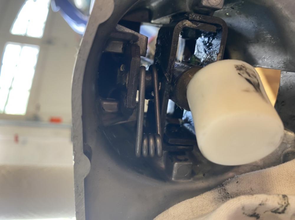

    Here’s the spring, installed. It keeps the gear in the 3-4 plane and you have to apply a litte pressure to the left to take the gear lever over to the 1-2 plane. To give you a sense. it is a bit less pressure than you apply to get over to 5-R, but it gives you a secure tactile feel of where you are in the shift pattern. No 5-2 shifts with this thing!

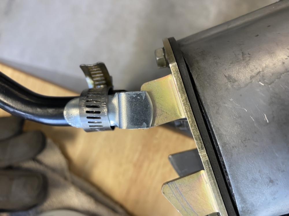

    Here’s the gate with tabs on 1-2.
    And here’s the inverted tab that holds the sprung lever on the gate tabs. Currently held on with a gear clamp but eventually I’ll tack weld it in place.
