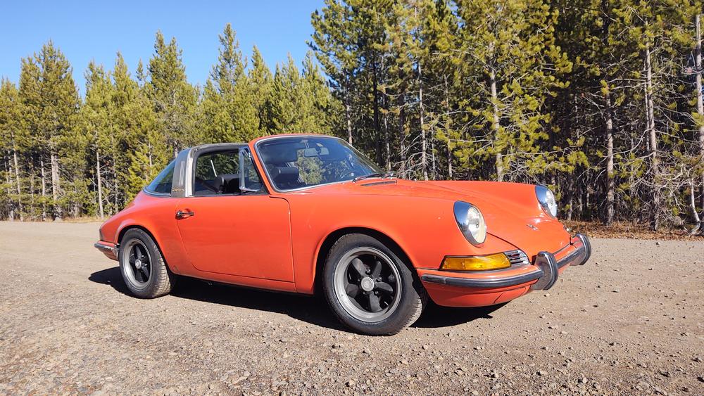

    I have the torq thrusts but the straight spoke version, not the flower version like yours. Milling the back is OK as long as you leave enough. I had a wheel shop mill about 3/16 in of the back to get more clearance, stock they will rub with suspension travel on more than a smooth road. Also had steel lugnut inserts put in so you dont have to use the flat washer style. However, with extreme travel, like one rear on the flat and the other wheel off the road angled that one wheel still rubs some. Looking at rolling the lip up just a little to see if that cures it. Other option is raising the car height a bit. I am running 185/65/15 Vredsteins

    Thanks very much for your valuable advice, love your car! I too have a 68 Targa. Your tire set-up looks great too. Milling 3/16 or 4.7 mm seems like nothing much at all...I was thinking 10mm if possible. All he best Mate.

    Ckali. Pic please..... I wanted the original look of taller sidewalls...... like to see the shorter one though..
