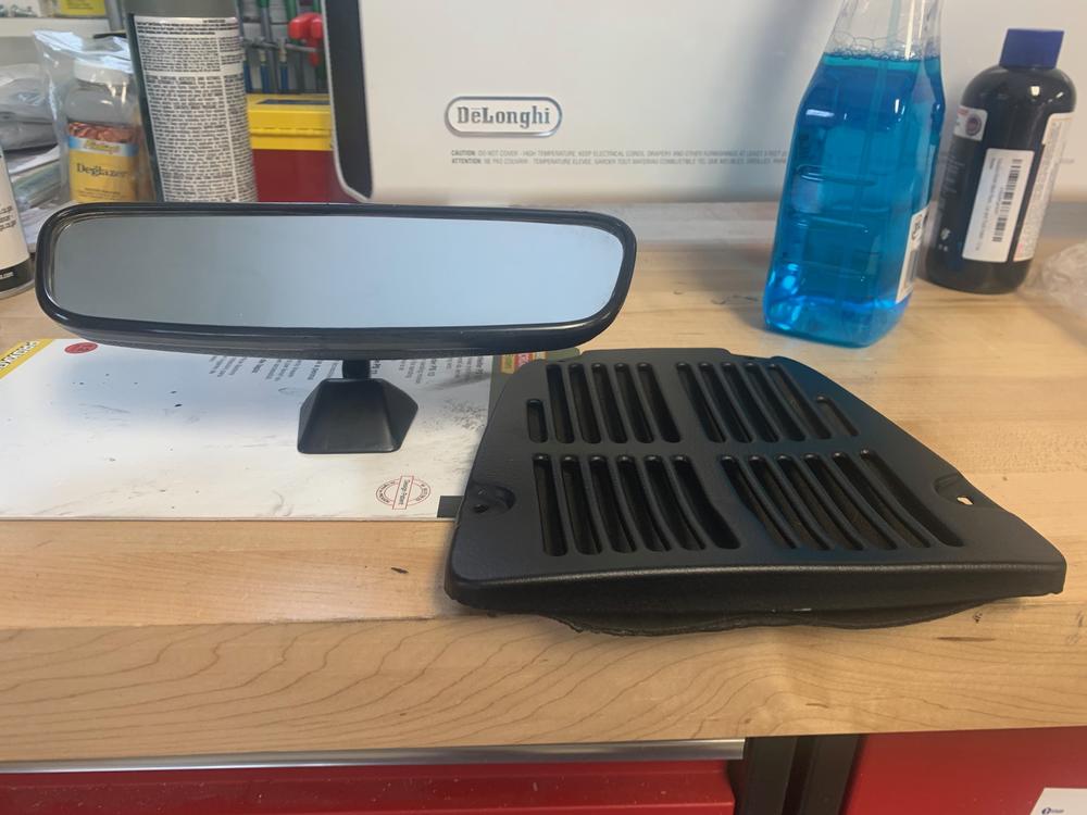

    One of my winter projects was restoring a LWB mirror, so not exactly apples to apples, but for what it is worth:
    I used multiple coats of Sonax plastic restorer gel - https://www.amazon.com/gp/product/B001054COY - as well as Fiebing's Leather Dye - https://www.amazon.com/gp/product/B000HHM20M - and Solution Finish Black Plastic & Vinyl Plastic Trim Restorer - https://www.amazon.com/gp/product/B006NZRAFE/
    The latter two help in turning the black back to black, particularly the rubber rim that surrounds the mirror. I would wipe/paint the dye on, leave it overnight, and wipe off what was left, and then repeat the process. In the end, the dye appeared to hold, but then I haven't had the refreshed mirror in the car in driving conditions yet.
    Also, for future reference, but not applicable to your chrome stem, I stripped the old paint off the stem with cleanstrip, then used a primer/etcher and the SEM matte trim spray paint. Unfortunately I don't have a photo of the back of the mirror, but I was very happy with all of the results (I stripped and resprayed my original tunnel cover at the same time, I have a replacement non-vented tunnel in the car, which is my fire extinguisher mount).
