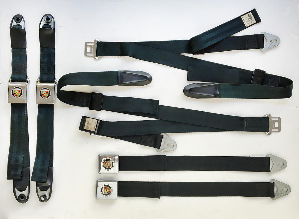

    My 68 has this type. Name:  2C4FF104-32AB-4F4C-8D67-100C816C9BF8.jpeg

    If your car was delivered in the US, It probably came with ASE/Hickock 3 point seat belts(installed in the US). The shoulder belt anchor for your car is located under the rear quarter windows and is the same SAE thread as the lap belt anchors.
    Jim

    Anthony's post was made at the same time as mine. His seat belts are a very good example of what your car probably had.
    Jim

    I have build date of 3/4/68 and they are what Anthony has posted.

    My 68 has a build date of 3/4/68 and they are like Anthony has posted. This is the first time I actually looked at them and they look like crap!!!!!

    Hello, does your chrome buckles have a recess shaped to fit the Porsche decal shape in it? My 68 has this belts but the buckles have the recessed area for the decal. Sorry, just wondering as the buckles looks flat on your photo. Thank you.
    Yes, has the recessed area for the decal.

    Thank you for the information! Looks like I know what I need now. What mejia_anthony posted. What is odd, is that I don't have that anchor point for the over shoulder piece. I looked in my wheel wells and they were either welded shut and undercoated YEARS ago....or were just lap belts.
    My car was US delivered (to New Jersey), left the factory 10/67, delivered to new owner 3/68. Nothing on my Kardex that refers to seatbelts/restraints.
