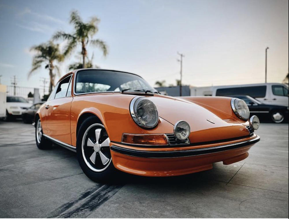

    So after sitting at the body shop for a while, my front shocks gave out (left and right) followed by the torsion bar bushings shortly after getting it out and driving around.
    Also live in the LA area.
    Car isnÂ’t tracked
    Just enjoyed on grocery runs, coffee, PCH, the 405.
    The chassis is a 1968 911L
    The suspension I believe is from a 1976S, (front and back) with an RS tribute.
    I donÂ’t need it aggressive.
    What would you do? Just change the inserts and Swamy bar bushing call it a day? Or?
    Here’s a couple of pics of my tangerine
