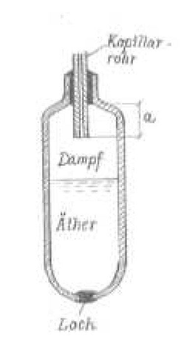

    Exactly be careful not to let tin get into the small holes. At the best to use a desoldering pump.
    3. When replacing the entire pipe: First solder the end to the sensor.
    Make sure that no tin clogs the small pipe opening. Therefore the pipe
    let it reach into the feeler a little. This also has the
    Advantage, when filling the sensor, an air bubble over the ether
    guarantee.
    ->picture one
    4. Now the feeler should be filled with ether. Arrange two cups with ice water or hot water (tap warm water is sufficient, the ether boils at about 35 °).
    Insert the free end of the capillary tube into the ether and hold it tight. Then immerse the probe in hot water. If after a while no more air bubbles can escape through the ether, immerse the sensor in the ice water. Ether is now sucked into the feeler. After a while, repeat the process until no more air bubbles escape. The feeler is now full.
