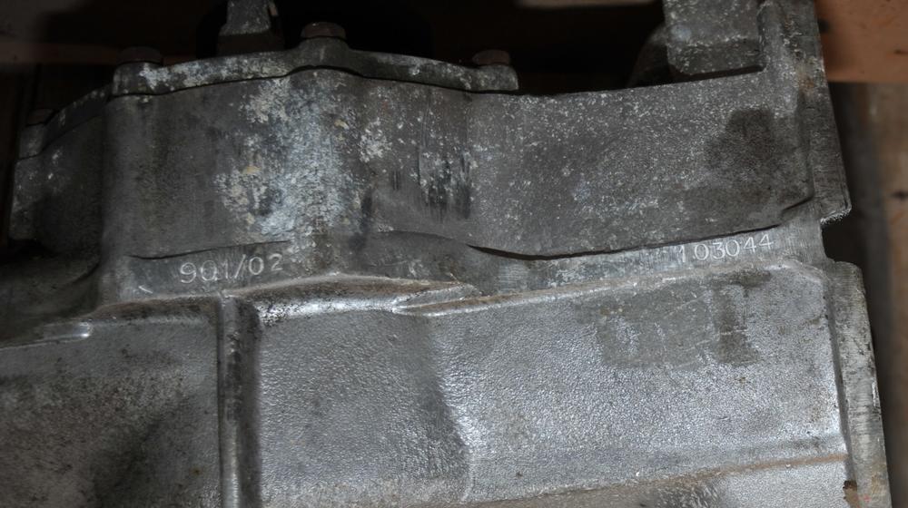

    Senior Member HughH's Avatar
    Dec 2004
    Melbourne Australia
    2,688
    This is not a 901/02 box but a very early airport gear set gearbox (901/52) from about mid 1967. I think that the fonts should be the same as a stock 901/02 one though.
    The photos were posted on the bird in about 2013 and I kept them for reference on the "sondergetribes" so (unfortunately) it is not my gearbox
Size:  126.3 KBName:  IMG_12451367263941.jpg

    Oct 2008
    Burford, ON, Canada
    4,239
    The font for the 901 should be barrel shaped, but the 104xxx does not look too bad. Also found one example that was 902/02, so obviously a typo.
    Also, I note the font of the second half of the type # tends to be different than the first half.
    Feb 2009
    Portland, Oregon
    2,355
    Clearly, different ways to stamp type and serial numbers. My experience with 901 type numbers is (901/) is a gang stamp with (xx) added later, usually with a different font.
    Fonts aside, the thing that stands out to me in the example given is that the rib on which the s/n is stamped has been sanded smooth. They always have those striations.

    Senior Member moito's Avatar
    May 2013
    AUSTRIA (tu felix)
    6,714
    Quote Originally Posted by tfiv View Post
    yes ,the hole thing looks/smells a bit fishy to me....
    big thanks to all who contributed via mail and post.
