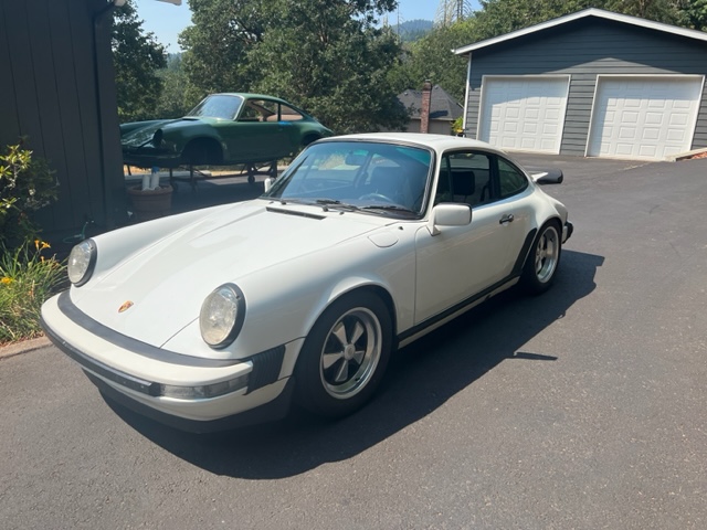

    As my 72 gets closer to the finish line I contemplate selling my 87 hot rod and then I drive it. 2500 lbs 3.4L twin plug, short gears, aluminum pressure plate, 930 brakes, blows ice cold A/C. Power windows and central locking. Remind me to never sell it. It's bad to the bone.
