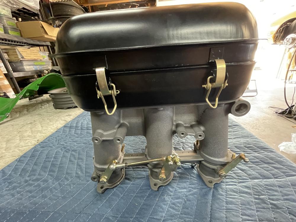

    Here are a few items that came Friday.
    What kind of finishes can be applied. Will Cerakote hold up?
    I would like the stacks to be darker. I would do the throttle bodies but I don't want to take them all apart.
