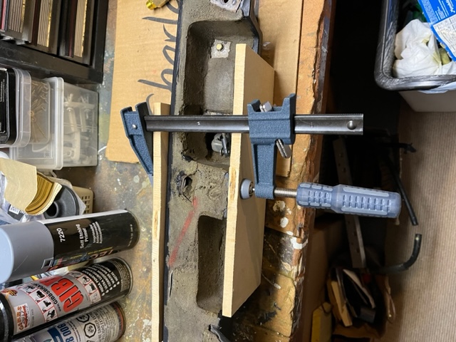

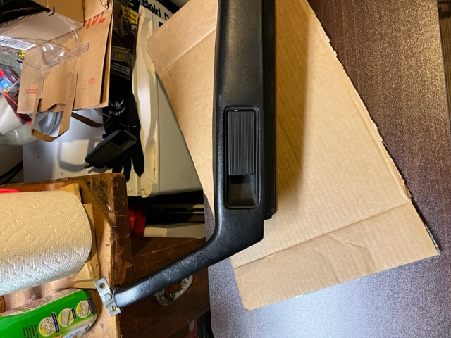

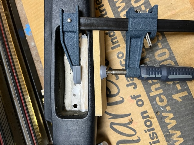

    I fixed mine up that way. They weren't bad to begin with but used a black interior epoxy glue (can't remember which one). I used the glue and clamps to fix up some weak and slightly warped areas. Came out really well and holding up so far. Here are some pics:

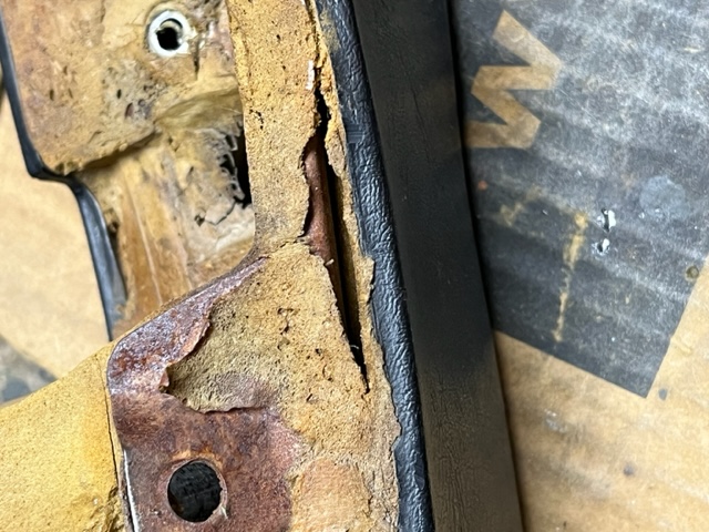

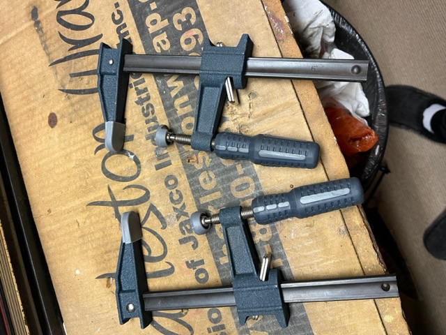

    There wasn't any thread I followed. I did search at the time but not much out there. Did read about one guy who clamped his and left them out in the sun, but that was about it. Figured I would give it a shot to make them a little better (as I said mine were pretty good to start). I had an extra set of real bad ones (see pic below) so I experimented on those a little. Anywhere where the foam was failing I filled with a filler using a small screwdriver and a plastic knife. I didn't think of it at the time but I bet a syringe would work pretty well too for some areas. I'm pretty sure I used JB Weld two part plastic filler/adhesive. Cut some small wood strips that were a real hard pressboard. After gluing/filling I clamped those areas and let it dry in my very hot furnace room using some cheap clamps I had picked up at Harbor Freight at one point. So far it has held up well and not come apart so I am happy.

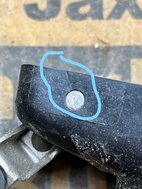

    Also - check your handles while you have them out. I have 4 of them and three where cracked.
