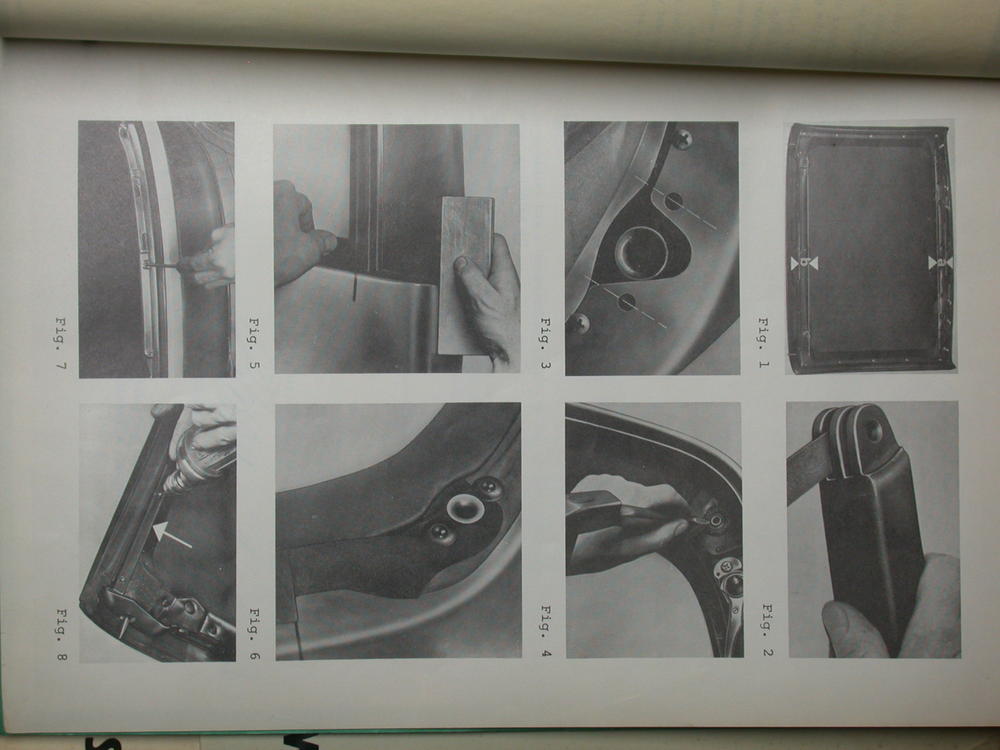

    Do you have a copy of the Targa bulletin by Porsche? I have a PDF somewhere, can dig it up for you. Loads of tips on how to align and adjust the roof.
    That being said, my Targa has a pretty good roof alignment and is still noisy as hell, open or closed. It's just what it is I suppose. Good-quality earplugs (for motorbikes) help to remove the wind noise while you can still enjoy the engine.

    Here you go,Its an 11 page instuctional.Name:  IMG_1983[1].jpg

    It's from 1968, so I don't know how helpful this is for later models.
    I can post the contents of the Targa Roof Repairs booklet too.
    Service Bulletin F 5/68
    28 February 1968
    Subject: Emergency action to prevent water entry, wind roar and rustling noises on the "Targa"

    i have always had good luck with the Targa tops.
    mainly because i have always adjusted the Targa frame to the workshop specifications and then performed the rest of the steps shone.
