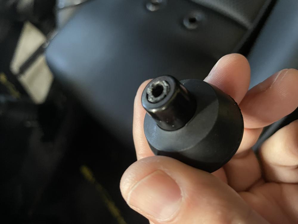

    Above photo of the broken end of the plastic shaft

    I think there is enough to fill the plastic shaft with clear epoxy, taking care that it doesn't glue the shaft to the switch.

    After taking the switch apart I realize that filling a portion of the shaft with clear epoxy is the easiest way that will provide a reliable repair and will allow the light to be seen through. Inside the shaft there is a clear rod between the light bulb and the knob. I can push that rod a bit more towards the light bulb and there will be enough space to fill the center of the shaft with epoxy. I think I'll secure temporarily the broken piece with super glue so that it stays in place while the epoxy cures.
