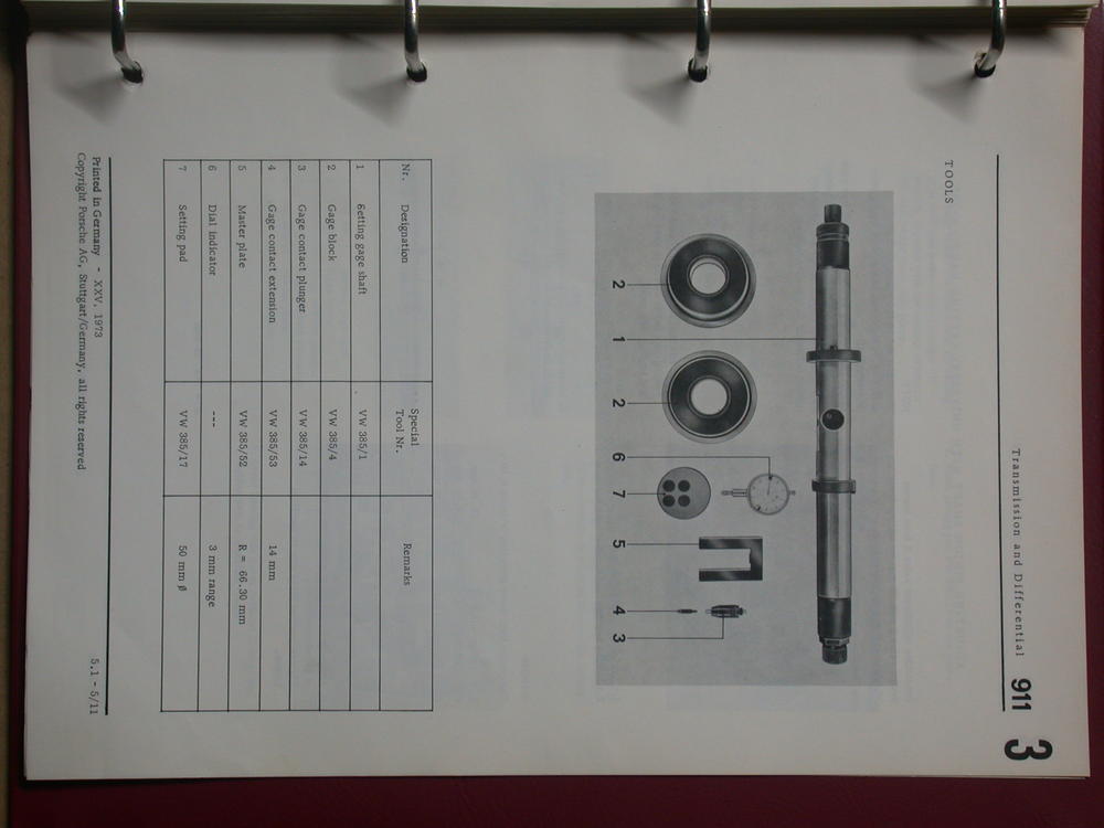

    VW385 Universal-Meßdorn zur Trieblingseinstellung
    Some background on this tool.
    It was created by Volkswagen, and introduced in 1970 as the Universal Mandrel for Pinion Adjustment.
    It was adapted by Porsche as an alternative to their own tool, P258, which it soon replaced.
    It was first shown for Porsche use in the Workshop Manual 911, Model 72, with an early 915 transmission.
    These Porsche manual pages are dated 1973.
