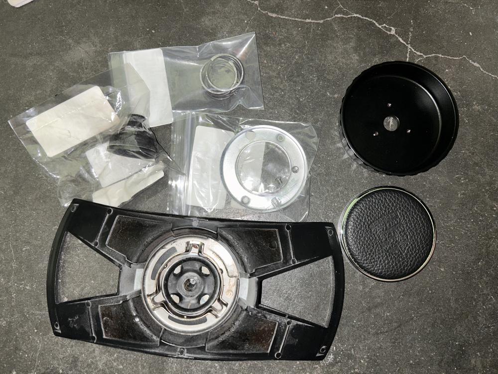

    Just got a repro 380mm VDM steering wheel and am wondering how the horn button (see pic) is going to affix to the hockey puck?
    Below the red arrow is pointing to the back side of the button. Is it press fit on there or - how is it held on?

    Since there are no slots on the hockey puck you need the chrome trim that holds in the leather button that press fits. The metal piece you are showing just fits on top of the hockey puck and the trim holds it in. You also need the attaching hardware to twist on the puck to the wheel.

    The chrome trim piece, do you have a pic or part number? Below is the old part & what I have. Thanks.

    The chrome trim is there on the button/piece with crest. It looks like the tabs are bent flat so push the button into the puck and see if pressure will hold it in place. You can remove it if stuck with a small punch through one of the holes in situ. Transfer the innards from old push to the puck and you should be good.
    Transfer the inside parts from your old horn first and then attach your new puck to the steering wheel. That way when you press in the leather button, the embossed Porsche emblem will be oriented correctly.
