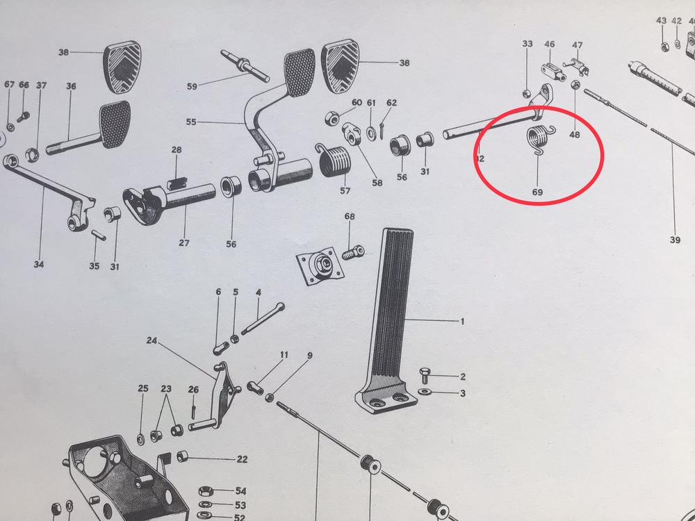

    From Chassis no 305 101 (MY67) a release spring (#69) was added to the pedal cluster, for all models.
    Was this an improvement/ update or did something else change in the clutch set up?
    Thanks
    Richard
    The release bearing changed. The spring is designed to keep a constant light pressure on the bearing.

    Yes , and there was a return spring on the clutch release bearing fork that was eliminated . Porsche wanted the clutch and brake pedals to be an even distance from the floor .
