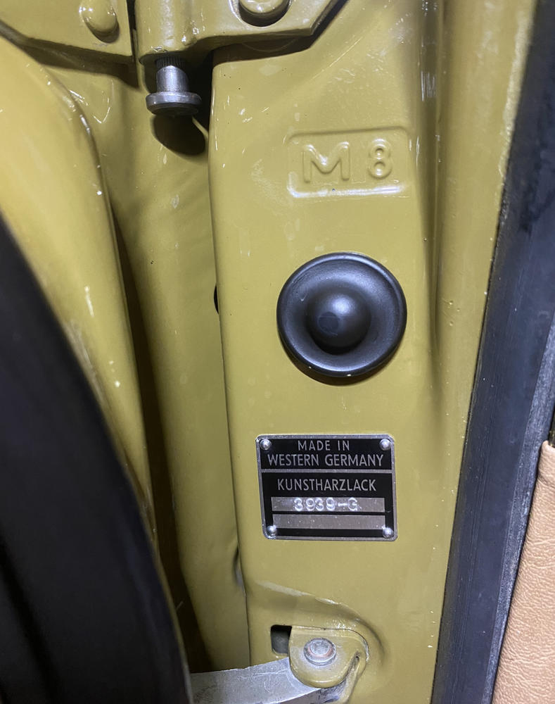

    I have done several plates, about 4 a couple weeks ago, both VIN and color.
    The metal stamps are available out of Germany, in several sizes.
    I practice over and over and over. I used tape to get the spacing correct.
    I mark up the tape, pot the numbers in the tape. And double check everything about 3 times, so 6 checks.
    And even with that, I messed up 2 weeks ago on a paint tag.
    I haven’t been offering because, it’s too stressful.
    The VIN tags are expensive now.
    I had to modify my metal stamps, and my ‘3’ isn’t as correct.
    I’ll try and find the German stamp maker.

    This company has a more correct 3

    From a 356, the old tag was just too far gone.

    Scott…
    Very nice work!
    Great to see the extra effort you make these for special cars ..
    Congrats !

    Scott, if you decide to offer as a service let me know. The ID plate looks good and better than not having one at all especially for DMV people.
