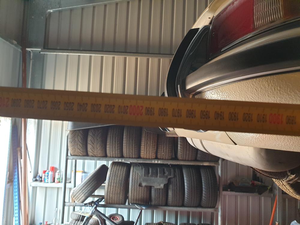

    Here you go, I have around 450mm from centre of post to rear pickup point.

    Thank you, that’s what I was looking for in a picture. Can you give me a measurement from the middle of the post to the end of the front and rear bumpers? I am putting a lift in my garage with the same type of adjustable arms, I understand that with adjustable arms the car can go forward or back a bit, but I want to get a good Idea of where to position the lift posts in my garage so that I am able to fit two cars in there.
    Keep in mind that with a two post lift front to rear balance is VERY important. It is easy to lift the car in such a way that if you remove weight from one end or the other the car can fall off the lift. If your primary use for the lift is for extra parking, oil changes, exhaust or engine and transmission work, etc. then a 4 post may be a good option. Of course the 2 post is better for suspension, brake and wheel work.

    So here are fairly accurate measurements off centre post.
    I mark a cross on the floor either side, for the position of the centre rear wheels.

    Thank you so much for the measurements and pictures. Exactly what I was hoping for. Also, thanks for the rust concern from 72 Targa. New pans under the car and down to bare metal body work in progress. So rust issues have been addressed.
