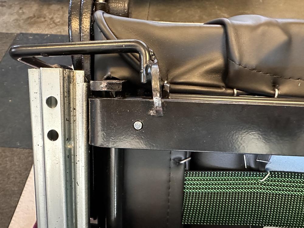

    There’s not much to do to install the seats to the tilting bases. It took me a few minutes of looking at both to realize that the bolts for attachment are in the attachment holes in the tilt bases. I know, duh, but it took me a while to figure out how the hell the seats attached to the bases.
    You’ll find there are four posts at the bottom of the seat, each with 3 holes for height adjustment. I’m 6’3”, so mine are mounted on the top most hole. Once you’ve figured out that you need to take the bolts (13mm head) out of the holes, the rest is easy.
    Turn the seat over
    Insert the tilt base between the four seat posts
    line up the holes
    reinsert the bolts through the seat brackets and tighten.
    That’s it, you’ve assembled the seat. A few things to remember, the seats and brackets are side specific. You want the adjustment knobs and bracket tilt release to be on the door side of the seat. Once you figure that out, it’s pretty obvious. One thing I learned on the first seat that made the second seat easier, was to thread the bolt at the tilt mechanism release first. It’s kind of a bugger to get to, and you can’t really get a socket on it, so it’s easier if you make aligning with the bracket threads flexible. I ended up having to tighten this one with an open end wrench, the other three were easy to get a socket on to tighten, although if you’re mounting to the top hole, the seat side fabric kinda gets in the way (so be patient).
