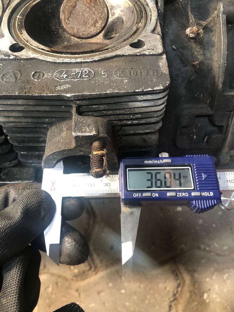

    I have found a set of 6x cilinder heads, it seems to be correct for ‘72 and 73 911S with casting number 911.104.307.1R
    Can anyone confirm?

    Given the dates and the "307" I would think this might be some "S" heads. Measurement of the intake and exhaust ports if they are original would help a lot.
    Just as a reference point: 911.104.307.0R casting were 1970 "S" heads, the records I have are late 69 production (for 2,2L).
    Ports measurements; Intake: 36mm Exhaust: 35mm

    The casting markings indicate 2.2/2.4 S heads. They should have the MFI injector holes and the stock intake port size should be 36 mm.

    Thanks guys, these are indeed for 72-73 911S and for RS (although the casting dates a not correct for RS).

    Yes 36mm and MFI ports
    Are they 35 or 36 exhaust? For my personal knowledge

    I think 35mm exhaust, but all is quite dirty/ hard to measure exact!
