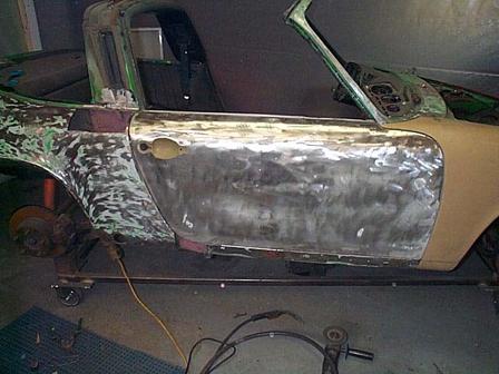

    And a door is added
    Then he put on the door, already ground down to the bare metal, and ready for priming.

    And a new fender to boot
    And then here's a shot of the passenger side with the door in place and the new fender installed.
