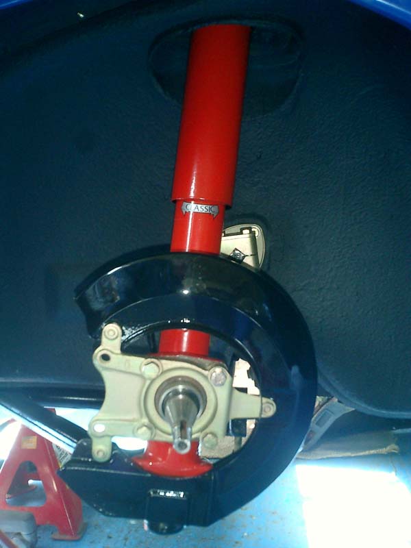

    I have just finished the restoration of a 68S #1054. It was fitted with Konis front and rear. The fronts cannot be rebuilt but new inserts are available. Vented discs front and rear, 3" spacing at the front
    Wish my suspension was that clean Nick! What is the finish in the fenderwell supposed to be? is it sound deadening?
    1968 911S Soft Window Targa
    The black finish is Upol Gravirex Stonechip which is like like bodyshutz but gives a more original finish for the early cars

    That looks very nice Nick. What sort of plating did you use for the brake backing plate? gold cad?
    Michael
    '56 T-1 356 bent window coupe...
    68 911L Burgandy Red R Gruppe #388
    72 911S Coupe, Sepia Brown
    Can't get cad plating done any more over here because of Health and Safety issues. Its yellow passivated zinc plating.
