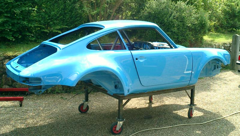

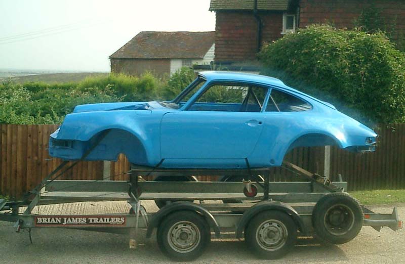

    I made my trolley from 50mm square tube, it has castors at every corner so is easy to manouever. I strap the shell to the trolley, and the shell to the trailer.

    My trolley is just for transport and early assembly work. The shell was restored on a Celette jig
