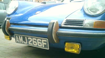

    These are on a French 68S
    Seattle WA
    3,516
    Here's a pic of the correct fog lights....
    The fog light pic that Nick posted appear to be the Bosch lights from 1974 onward.
    The lights that you mentioned that are more angular, are for 1969 to 1973.
