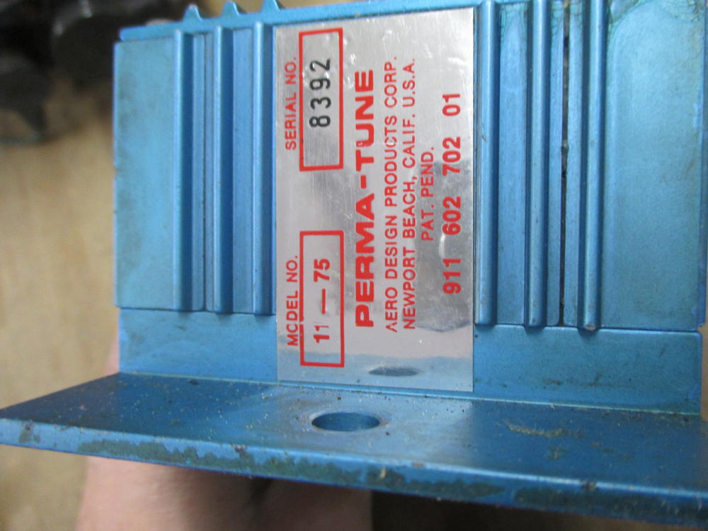

    old threat--new pics
    have several of them all dated late 75 to early 76
    NOTE the triangular porsche "warenzeichen" trade mark
    but i have been told that in 72 they also were short on bosch boxes--anyone to confirm this?
