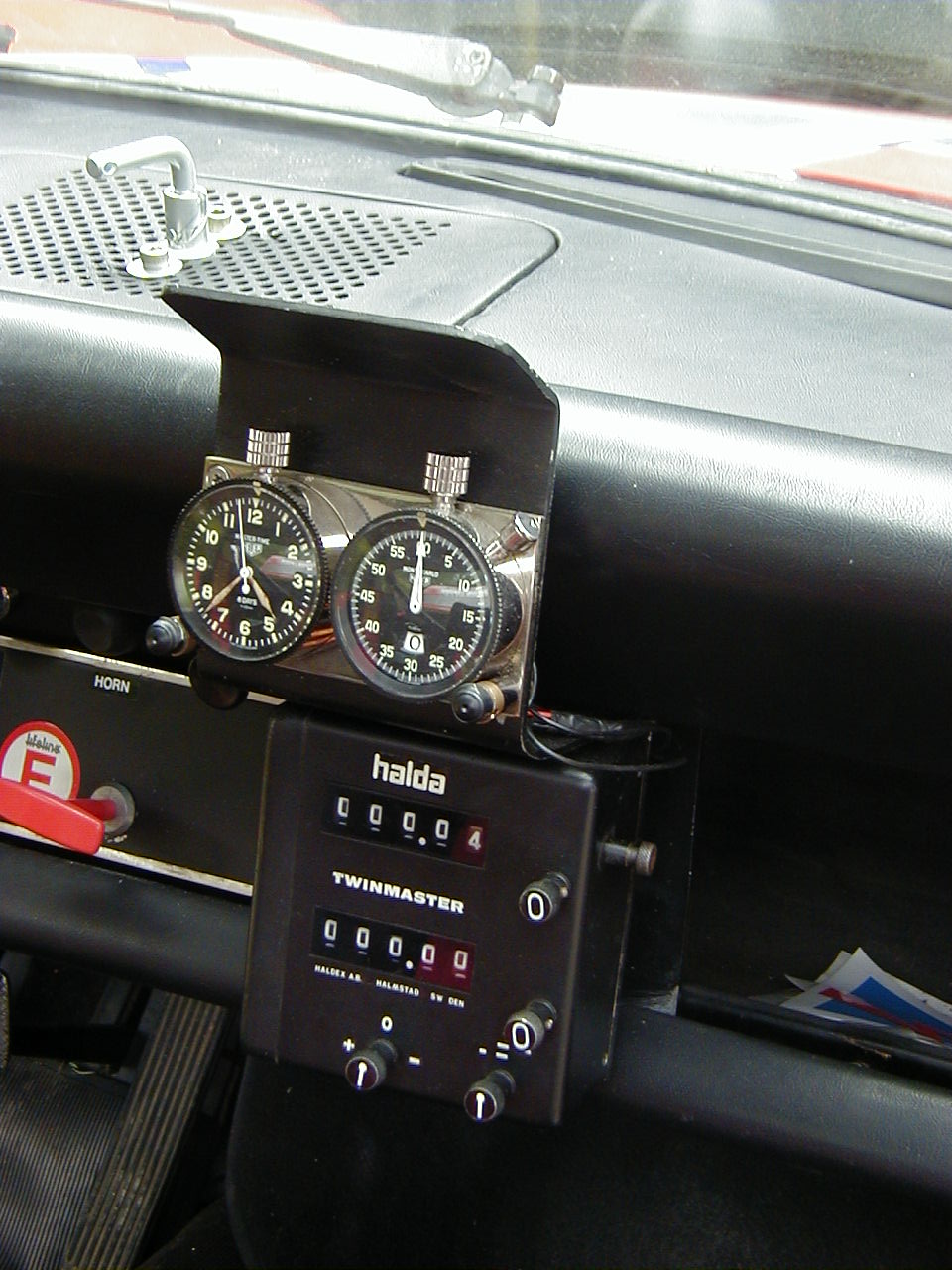

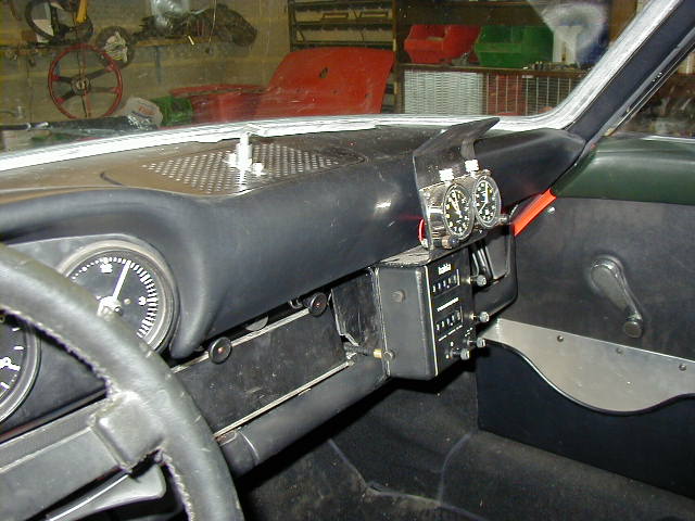

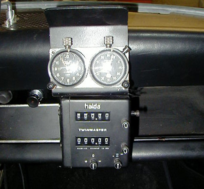

    Here are a set of clocks and Halda as fitted by the factory to a 1970 works 911ST
    The glovebox door has been removed and the Halda mounted to the door mountings

    An excellent technical & pictoral response , as usual, from you Nick.
    I just loved the 'door pocket' in the edge of one shot. far more practical for rallying than the std Porsche item, and a lot cheaper to reproduce I am sure.
    Boy, how I wish I hadnt sold off my Halda Twinmaster after my University Car club rally days....

    Thanks for the pics Nick !!!! I will try to post mine once I figure out how to do it. That metal case Twinmaster looks real awesome too !!!
