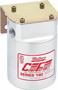

    Thanks Rob! I'm thinking about mountng an aftermarket spinoff filter. I've got a few US-made units in mind but does anyone know of a 'proper' German-brand spinoff filter?
    What do you mean Curt, aftermarket, or ,, as original... if so,,, I still have a few originals..
    Robert..
    [SIGPIC][/SIGPIC]Robert D. Groß
    Sunshine State
    5,780
    I was thinking aftermarket. I just need something with a simple inlet and outlet - those originals look fairly complex, besides the issue of filter availability.

    Harry - It's carbed. I've been running an in-lne but I think a spin-off would be easier to change and a more permanent solution. I was hoping Mahle or Bosch offered something like this, but I haven't been able to find anything.
