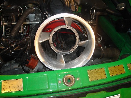

    I have just removed the fan, fanhousing and the alternator. It was corroded and dirty and I wanted to try do get it nice and shiny again, just as the examples I have seen in another thread at this board. The picture shows the work halv done after many hours......
    When I removed the fan/alternator from the housing I heard a rattling sound inside the alternator and when I shook it, the small halvmoon metal piece fell out. Is it supposed to be inside the alternator or do you think it has fallen into the alternator from somewhere else, or just left there by mistake?

    Thats the woodruff key I would take the pulley off the altnator and make sure there is one still installed I would think you are safe to remove the strap I would just retorque the nut
    hello: You will have to take the fan off the alternator shaft to find where the woodruff key goes. When you put the key in the shaft make sure it does not fall out again or slip up behind the fan. You can put a little grease on the shaft and key to hold it in place and stop rust. Thanks Eric

    I will follow your advice and try to remove the fan. Last night i carefully tried with a rubber hammer but could not get it of. I guess I will have to try again with some wd 40/heat or some thing. I am also wondering if I should just polish the fan and housing or treat it with something.

    Fan is off.......
    WD-40 and a rubber hammer did the trick, the fan is off and the woodruf key is in its place ? The other woodruf key must have been misplaced or may have fallen into the alternator at sometime. I found out that the plastic air cover behind the alternator is still available from Porsche so I ordered a new one. It was 100$ for it. I will try to get hold of brushes for my Marchal alternator, on another tread I got a tip that Volvo 140 had the same.
