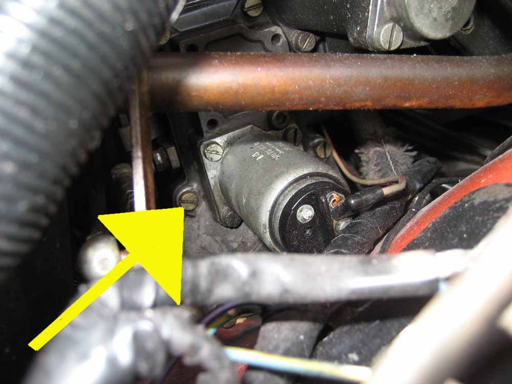

    Looked over the microswitch and found the adjustment screw all the way in and still not activating the switch at closed throttle. I assume the arm needs to be bent up a bit. But with the engine at 2000 RPMs and manually cycling the switch, it did nothing. So before I dive into this I just wanted to make sure of the components. Picture one shows the RPM transducer arrowed in yellow. microswitch in pic 2, and RPM soleniod in pic 3, yes?
    Also, searched through the Pelican site and couldn't come up with the RPM transducer rebuilding thread. Any help would be great. Additionally, after going through the Pelican site, I noticed the mention of a speed sensor that suppose to be incorporated into this system. Something about energizing the RPM transducer with 12v after it reaches above 1600 rpm. Any one have some more info on this?
    Thanks Allan PS sorry for the sad state of my engine compartment, but have the car done and that will be next.

    More detail on the RPM transducer can be found here:
    http://forums.pelicanparts.com/showt...hlight=mfi+rpm
    The microswitch you have is not the original style, so that explains why it is not actuating. I found a replacement at Parts Heaven (Hayward, CA).
