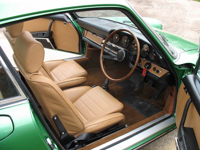

    I would forget about the galvanising, it costs £10,000 to do here in the UK and if the shell is properly restored and protected with Ecoat and waxoyled regularly it should last much longer than the original. I wouldn't think that the potential price increase for a galvanised car would cover the cost or even make the car more saleable, the quality of the restoration would be more important.
    Fitting power brakes would require some metalwork modifications unless some hi-tech system is developed and I think would spoil the car. Correct Recaro Sports seats would be a great addition as they are a peiod modification and much more comfortable than the standard seats.
    Keep it as it left the factory to maximise value if you ever want to sell the car. I restored this 72S last year and the only change from stock was to trim the entire interior in leather, in the same colour as the original vinyl.

    Nick, your restored car looks fabulous. Was a wood steering wheel really stock (or an original option) on a '72 S? If so, I may just get one. It is really a lovely touch.

    The wood rim wheel was a temporary fitment while waiting for the original wheel to come back from the trimmer.
