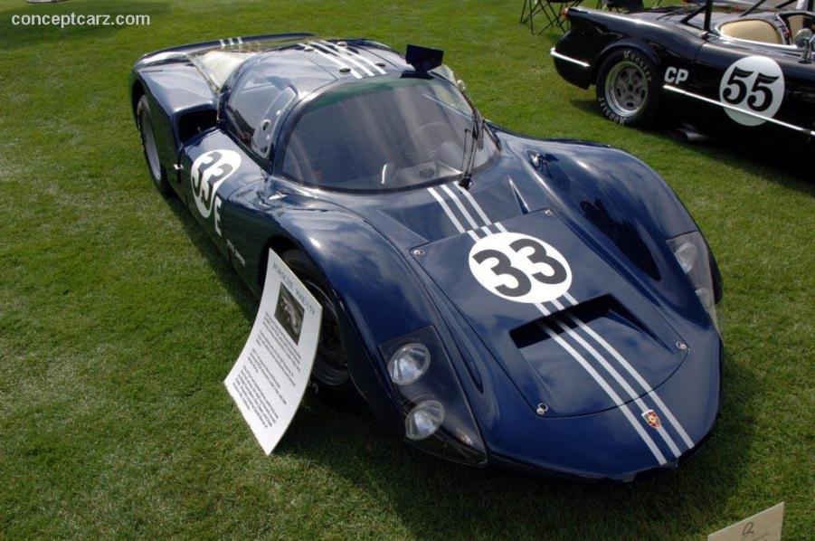

    Marco;
    The 906E used Bosch mfi with slide throttles. This one was owned by Cunningham, Zipper, Polak and is shown in long nose, short tail configuration as when it won Daytona in 1966. Nice!
