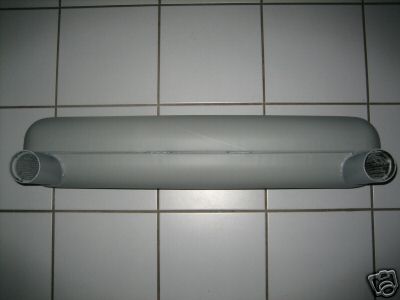

    Hello all, looking for advise as to what is correct diameter for the ST or RSR twin muffler outlets. Is it 2.25", 2.5", 2.75" or bigger ???
    TIA !
    Yes, BIGGER!
    The outside diameter of the twin outlet pipes on the factory ST/RSR rally silencer is exactly 7.0 cm. This dimension is equivalent to a diameter of 2 and 13/16 inches.
    This is the muffler used to match up with factory tubular exhaust headers or "spagetis" and short megaphones or "diffusoren."
    This style muffler was used in 1970, 71 and 72 on 911ST and 914-6GT and later the 2.8 RSR.
    Here are some photos. The two upper images are of a 911ST/RSR system. Note old time factory nickel plated spagetis.
    The lower image is of the 914-6GT set up. Note the difference in where the outlets are placed.
    The GT set up reputedly came off the Sonauto LeMans GT Class winner. The 6 GT headers are also shown.

    I think you meant to say 70mm or 7cm not 7.0mm
    Also, it looks to me that 70mm is almost dead on 2 3/4"... what'cha'think ?
    Cheers,
    Chuck - thanks; yes of course 7.0 cm.
    On the Aeroquip mic looks like 7.0 cm equals 2 13/16 to me.
    But I am farsighted as well as prone to drop decimal places!

    Has there been any atempt to catalogue the various part number for sport mufflers? This thread peaked my interest to look on my shelves for an old sport muffler I had not looked at in many years. It appears common variety, is made by Leistritz and has part number 901.011.09/07.
    Having a 914-6 I am familiar with a site that has some interesting early exhaust images. http://www.pbase.com/9146gt/rally_muffler_of_a_gt
    One image shows an outlet being measured with a caliper. tom

    Does anyone sell repro's of the RSR muffler, I need one for 73 Replica.
    Thanks,
    Phil
    Repro
    Phil:
    I think OliveR has complete systems.
    You could also consider getting the muffler shop to mod a standard muffler to get the "look" using some 2 3/4" pipe ( as Chuck points out) and retain the use of your heat exchangers.
