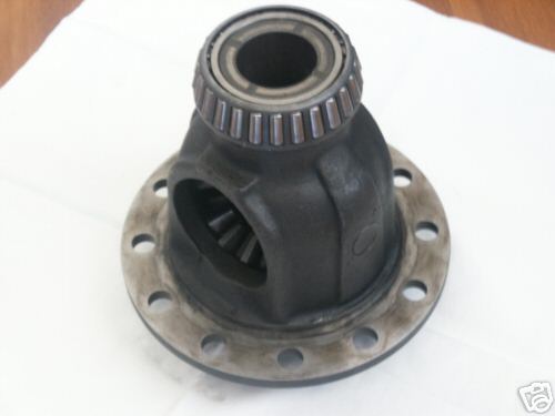

    What is this and for what year?

    Looks like a non-simplified diff. 70's era......

    For reference, any part numbers stamped on it?
    Peter Kane
    '72 911S Targa
    Peter, I do not know, its on Italian Ebay with a BIN of around 300 euros.

    John, that is basically a boat anchor, it's just a standard open differential, hardly worth even 100 euros. Now if it had a 7/31 915 ring and pinion with it that would be different.

    I agree Ed...but maybe I should list it on the euro ebay....can you imagine 300euros....I do have the R&P for it from a 71 911 trans
    Here is a picture of a 901 LSD

    Glenn, judging by the male type stub axle that would be a very early 904 type LSD wouldn't it.
