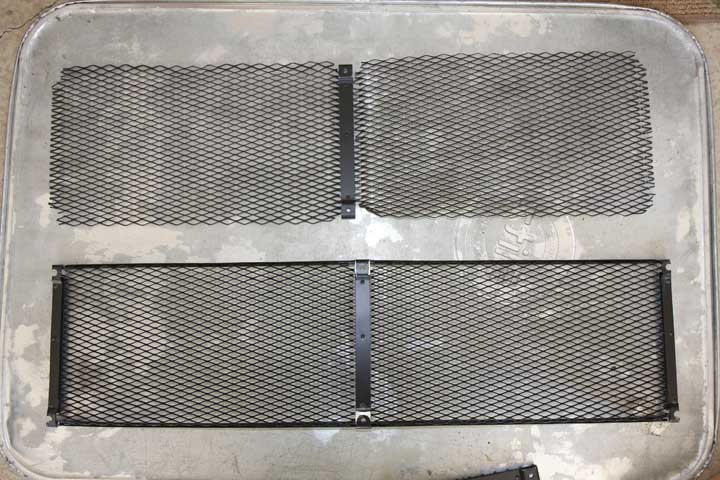

    The grill can be made from a 3 bar grill that is basically turned upside down. You need to remove the all the alum rails and shave the side bars. It's very straight forward BUT there is a lot of fine tuning to get it to fit.
    Version 1.0 is the quick and dirty grill. It works but 2 things worth mentioning which lead to Version 2.0.
    First, the screen sags in between the bars and doesn't contour the curve of the decklid. Second, you need to use large washers to "catch" screen to mount. The screen will break over time so you have a sagging corner (or two or three or all).

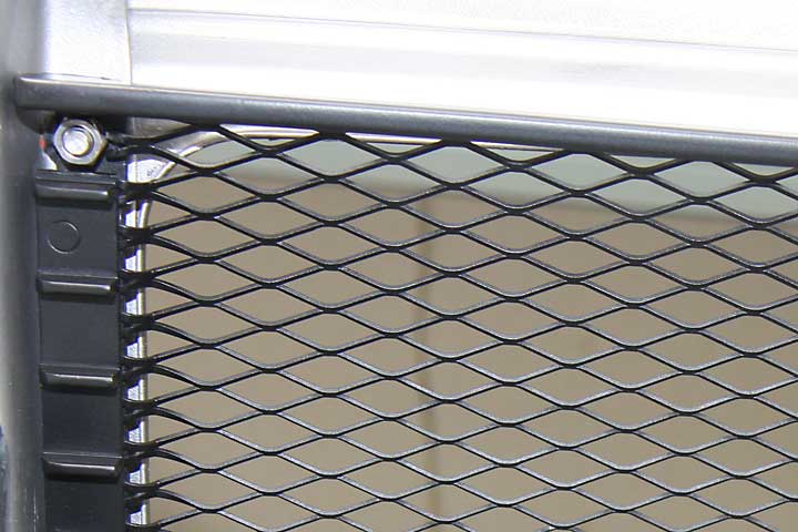

    To make Version 2.0 which contours the decklid much better and will not break away at the corners you need to keep the side bars and two alum rails.
    - Remove all but the top and bottom rails.
    - Cut the extra alum rail that goes beyond the outside bars.
    - Remove the bars and shave about 3/16" from top to bottom (marked with yellow line in pic on original bar). The grill will not fit in the recessed area of the decklid if you don't do this.
    - Cut away extra material (marked in green) to give you enough play to mount bolt. You need this play as you will see if you don't do this - it won't line up to the existing small hole.
    - If you can get away with not cutting the area marked in red then you will not have to JB Weld it back together like I had to do. These parts will separate and you will have a sagging corner which defeats the purpose of keeping the rails for a nicer contoured fit. This is why my grill came off to fine tune the fit. You'll just need to fine the right mounting hardware to save you from the JB Weld phase.

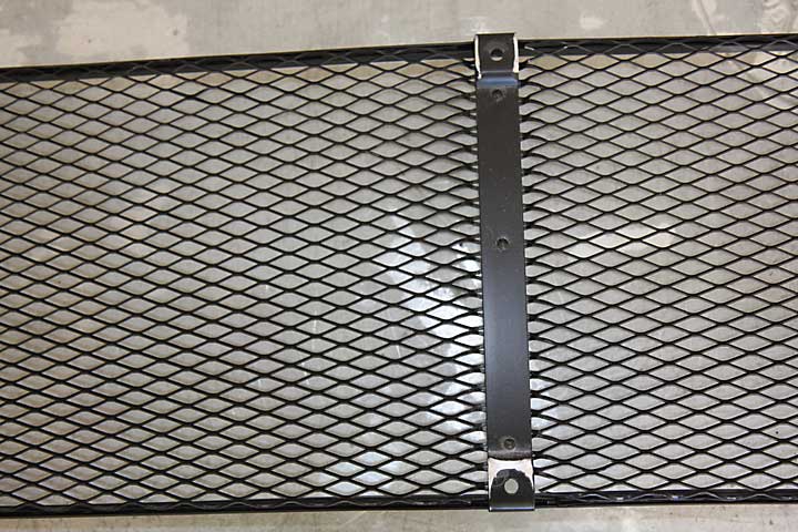

    When you're done with the bars it should look like the pic below. Note the radius corners (in yellow).

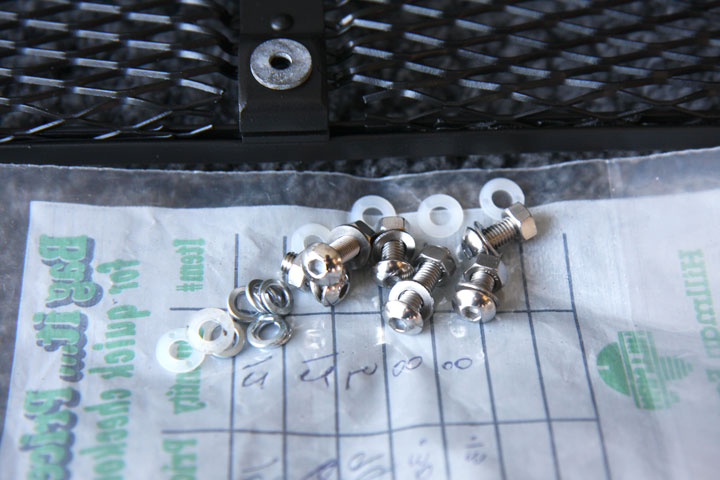

    I chose polished button heads to finish off the look on the exterior. You will need longer ones for the center bar. Also, use neoprene washers on the underside and nylon washers on the topside. At this point you will just need to fine tune the fit with some final grinding. Don't forget to use masking tape to protect decklid and hinges - the fit is tight and you will be sliding the grill in several times...trust me. Also, you may need to drop your coil about 3/16" so that it doesn't rub against the rail.
    That's it - very straight forward...just a lot of fitting.

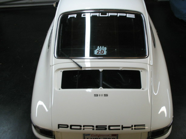

    I want to give Bob Tilton credit for advice on the grill I used on my '67S Rally car. The picture is not totally clear but you will get the idea. I did a couple of my own mods but Bob should get the credit for the idea. See pics.
    Thanks Bob.
