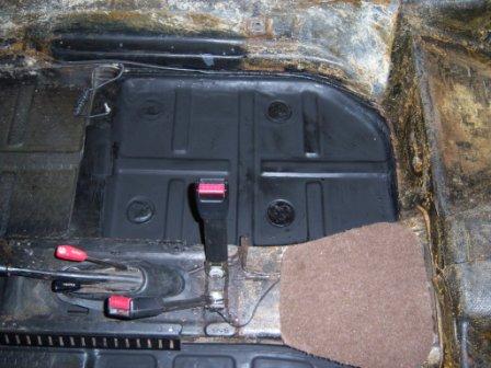

    Look on the AutoAtlanta web site. They sell some products from Worths (Scottish company). It goes down easy and can be painted once installed. Here are a few photos of a car I recently used the product on. The first photos are of the floorboards w/ POR 15.

    Here is the part. Supposed to be painted in a 914 and left plain in a 911 according to "AA" parts folks.
